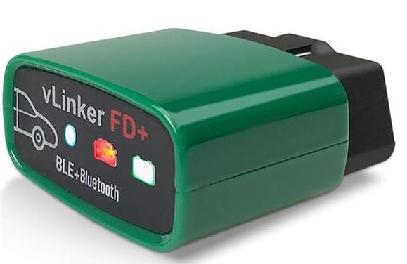

Pouzivam tento BT adapter, ktory by mal s Forscanom android apkou bez problemov fungovat
2024-12-10 12_12_07-Amazon.com_ Vgate vLinker FD+ OBD2 Bluetooth Scan Tool, Diagnostic Code Reader f.jpg
