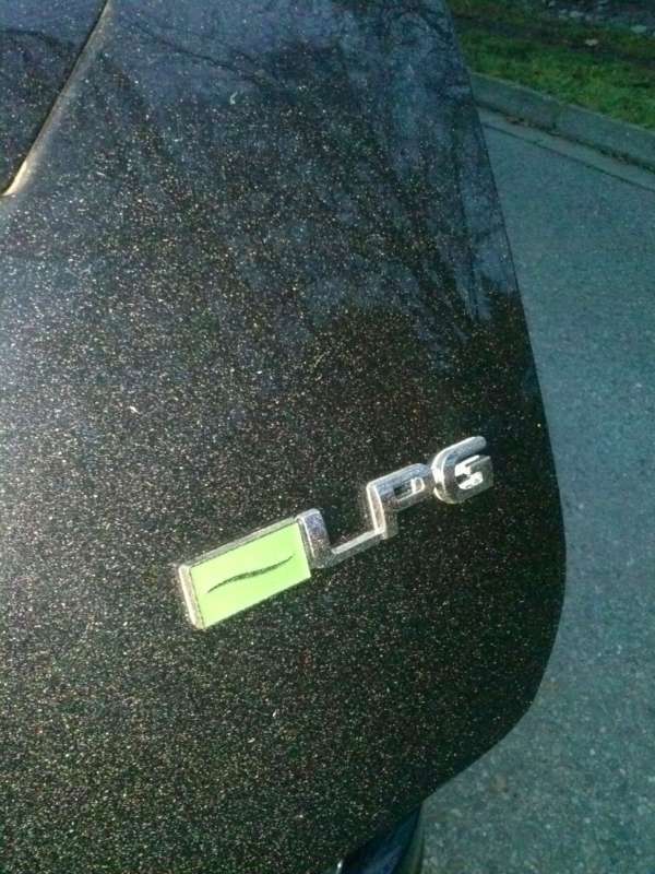

Co povite na nove oznaceni meho FoFo?
FORD Focus ST-Line, 2018, EB 1.5, Bluefin 151kW (love it!)
