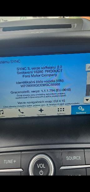

Zdravim,ZaQik píše: 15.07.2025 20:03 mapy F14 do SYNC 3.0 (tedy ne 3.4 !!!)
http://ivsu.binaries.ford.com/swparts/J ... 000.TAR.GZ (mapy)
http://ivsu.binaries.ford.com/swparts/J ... 000.TAR.GZ (hlas)
http://ivsu.binaries.ford.com/swparts/J ... 000.TAR.GZ (licence)
muzu do teto verze nahrat mapy F14?
Diky
